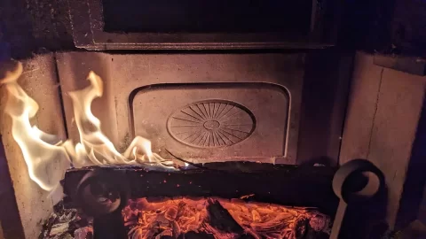

[Hearth.com] VC Dauntless FlexBurn Fire starting and maintining
Now after you see the flames going well, not too high like a blast furnace but not looking like the flames are going to go out.
What your looking for is a nice slow to medium dance. Add the "chunky" kindling on top and push all this to the back of the stove
let this burn good and adjust the air control for more or less, but I leave it the same position to make it easy.
Now when you see this "chunky" kindling going well throw on your normal wood on top and actually push it back as far to rear of the stove as possible.
The furthest away from the glass as possible.
You have already gotten over the hardest part of the Dauntless now comes the easy part.
Once you put in the regular wood wipe the glass off with a paper towel. The initial smoke will wipe clear easily.
I wipe my glass down every 7-10 logs and its staying extremely clear. But make sure when you load the stove you are pushing the wood to the back of the stove away from the glass

How do you know you got a good burn going? look at the Inside of the stove with the log burning, the ceramic is nearly white and the bricks are white!
This is letting me know I have a complete burn and the creosote is not building up too much.
