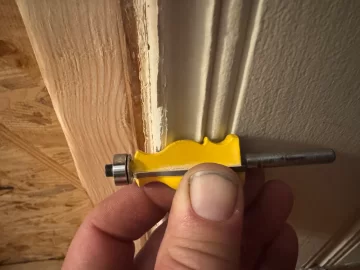

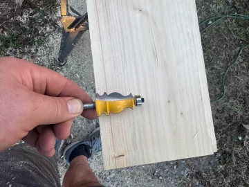

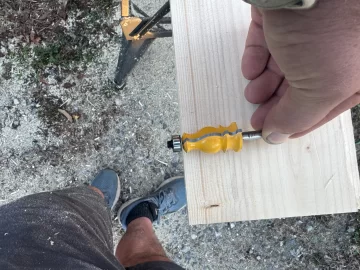

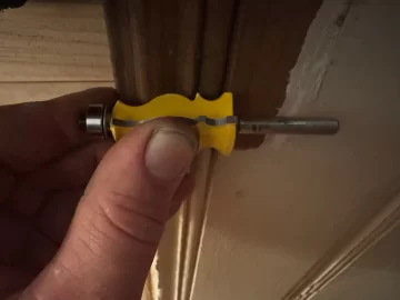

It needs to be reversed from this one but I can’t seem to find one.
It fits my wall boards, and I could cut the tongue out of the excess part of the longer sweeping area, and it would be a darn near exact match. EXCEPT, it’s oriented the wrong way.
If I just move the design to the other side of the board, I can’t trim off the excess sweep, and the profiles don’t match and it would be about 3/8” wider than its neighbors.

That is interesting. I have a router, but never ran into this issue. I wonder how they are made? Can you take one apart? I guess you already thought through the upside down mounting ect and that is a no go.

This seems to be a one piece. The tongue and groove ones you can take apart. This one is solid.
I could strip out 1-3/4” sections and router that, then make both sides of the narrow, decorative strip male, and have the wide blanks be female on both sides. Lotta work and lotta extra joints.

If you're just doing a few pieces, I would mill the edge of a board with the bit you have, then rip off the molding and join it back the other way. A bit more work to setup but shouldn't be too hard.
If you need to do a lot, bring a piece of the original trim to your local lumber mill and ask if they can identify the profile or perhaps make a custom bit from your sample.

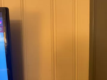

This is just with the primer. It’s got a 5/8” tongue and groove, so it’s locked in.
