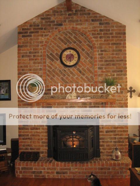

I’m new to this forum. Thought I would tap some of the expertise and experience this forum offers. I need suggestions on what changes should be made in order to obtain optimal performance from my newly purchased insert. All suggestions are appreciated.
This is the best local deal I could find: Quadrafire Mt. Vernon AE insert. $3588.00
Quad online manufacturer rebate - 300.00
1 ton free pellets credit - 215.00
Delivery, install and setup ( with existing 3” vent ) + 150.00
Sales tax + 268.00
Fed energy rebate to claim on 2013 taxes - 300.00
Total for everything $3191.00
Just replaced our 12 year old Country Flame “Little Rascal” insert with a new Mt. Vernon AE insert. Our house is 1362 sq ft main level with a 1362 sq ft walk out basement. We have a propane furnace with winter thermostat setting of 68 degrees. Our new insert will be used as the main level heat source. It is installed in our family room that has a 13 ft ceiling with 5 ft diameter fan. Stove date of manufacture was 3/12. Installers said that OAK was not needed. The installers used a 12 inch piece of Duravent and an adapter on the insert which connects to the existing 3 inch flex and 3 inch x 15ft of double wall pipe. All of this is installed inside a masonry flue located in the center of the house. The existing flex goes thru the fireplace damper opening that has no block off plate or insulation. The top of the flue has a flat aluminum block off plate with a storm collar on top of it. The vent pipe and rain cap terminate about 14 inches above the block off plate. Total flue length from top of insert to rain cap is 18 feet.
Initial installer settings Heat out = 4, Flame height = 4, Temp diff = 2, Convect speed = Normal, Elevation (alt 1292)= Normal, Fuel type = HW pellets. Note: with these settings the air out is 200-210 degree range.
EDIT 3/21/13 settings changed ; Heat out from 4 to 3, Flame height from +4 to - 5 , Fuel type from HW pellets to corn ( for longer duration between auto clean ).
The installers suggested that I try using the 3 inch since its already there to see if it works ok. Will the existing 3 inch vent handle it or should I install a 4 inch?
What symptoms/conditions indicate that I need to increase to the 4 inch vent ?
If I go to the 4 inch should I use flex or double wall? Which brand /type suggested and where online is the most reasonable place to purchase it.
I am using Somerset premium hard wood pellets that cost me $172 a ton.
Have there been any software or part updates since this insert was manufactured in March 2012?
Should I unplug the unit during the cooling season or should I leave it powered up?
Any other hints for the operation, maintenance or cleaning on the Mt. Vernon AE insert?
Again, thanks for all help, comments and advise.

3" vent pipe should be fine. I have never burned Somerset's, but from what I hear, they are a premium hardwood pellet. When I burn a good quality hardwood, I need to set my flame height at -4 to -5. I would think you are wasting pellets at a +4 flame height. With dense pellets you want less fuel and more air. Set your stove to manual high setting and let your flame react for awhile, then adjust your flame height setting down to a lower number and again let it settle for awhile. You want the flame to hit the top of the diamond on the baffle. I am willing to bet you can at least set it to a -4. When done set your heat output to medium high again and your flame should automatically adjust to proper height. Even with mine on -5 and set on low, my flame is high with Turman hardwood's.
if you need four inch you wont be getting enough air, not enough air is not only caused by too small of a pellet pipe but symptoms are black soot on the glass (tan/brown is normal and expected) large lazy dark orange flame (healthy flame is white/yellowish orange and very active like a blow torch kinda) and in most severe case you could have vacuum switch errors.
inside an existing chimney use flex liner, olympia chimney liner is a good quality name brand, lifetime warranty fully transferable to new owners...
somersets are a good pellet and people have paid much more for far worse than what your buying those for
update, ill try to do this from memory, select menu, then user options, then scroll all the way to the bottom and i think its something like "stove settings" possibly, if you selct it a bunch of weird letters and numbers should come up, look at the upper right hand side and you should see something like ufti and if you have hardwood selected 005 should be next to it, so with ufti 005 below that is rev then your rev number if it is lower than 040 with hardwoods selected you dont have the newest fuel table program on your unit, which your dealer can get you the newest fuel tables if they have the program and the adapter and the newest fuel tables off quads site and they actually know how to use the everything together which not all dealer do i believe....
first off you should always have the unit on a power surge protector as the board and AC to DC converter are not warrantied to power surges and you dont want to have to buys those, $$$, and when not in use in the summer the safest thing to do is to unplug the stove.
somersets from my experience are short 1/4" to 5/8" generally and will feed faster than a moderate length pellet (1/4" to 1") that +4 flame height/feed adj. seems a little high for the type of pellet your burning but if the unit starts well and runs well then you cant argue with the real world experience.

yes properties, i thought i had the last name wrong. ufti indicates you do have it on hard woods and for the hardwood setting it has the 030 fuel table, the newest is the 040 but the only difference between the two is with 040 they reduced the ignitor on time slightly and reduced the number of retries after a initial failure to light, so if the dealer can not do it i wouldnt worry about it too much as quad ignitors are the cheapest oem ignitor i've ever seen and very easy to replace, except from the factory, whoever that person is that tightens the wing nut down with what must be vice grip fingers i'd like to meet them.
that is a very good price, 600 off the stove, dealer splits half of the 300 coupon with quad so 150 there and 215 credit on pellets and an install thats much less than what normal for most dealers. the bad side is while the profit isn't totally gone for the dealer if you have warranty issues beyond a simple ignitor, something that takes time to troubleshoot and repair, the dealer, not quad, has to eat labor and the dealer in this instance may be reluctant to but each dealer is different and they may be happy to, although hopefully you dont have any issues to begin with for many years to come, it is a very nice unit.
Hi Rowdy, nice to meet ya welcome to the forum. Beautiful stove, you got a great deal too. I would prefer a 4 inch liner but a 3 inch will work fine too I believe, after using your stove, you'll know if its an issue. Good choice for stove too, I'm waiting for spring (and golf) to come to CT. Take care
