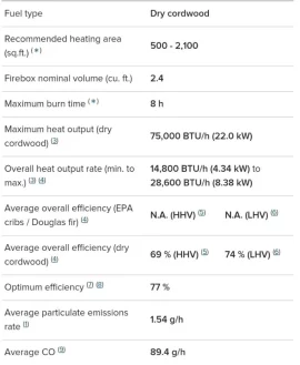

What are your thoughts on this kit
Never heard of the stove. Seems really cheap. Price wise...no comment on quality of the stove and/or liner.
I can definitively tell you that I can not buy, at my cost (read-"wholesale"), a full liner with insulation and a quality Regency insert for anywhere close to that price let alone make any money on it. Like I said, never heard of the stove but I'd be really really leery of it.
[Hearth.com] I need new efficient wood burning insert ASAP
Not in my house!
It does have a reasonable firebox size, and a somewhat adjustable burn rate, which is good.
It also has a rotten efficiency and a tiny burn time- and those are the optimistic numbers that they are advertising.
I guess if someone was home all day I could make that work, but that's not the situation at my house.
And while that is a very cheap price, try to get an insulated liner.
Your first step should be to see how much room your chimney has for a liner. A 6" insulated liner might require 7.5-8" to pull through, an 8" liner might need 9.5-10".
First, get your chimney cleaned then measure your fireplace AND flu dimensions to see what will fit.
SBI is a large Canadian stove company with several brands and models. ie Century, Drolet, Osburn. Anyone that sales stoves should at least know the Osburn brand. Keep in mind, some on this site sell stoves and the Century and Drolet brand are big box stove brands. Lowes, Home Depot, Menards, Northern Tool... Osburn is a Stove Dealer brand.
As I mentioned, Century CW2900 or Drolet 1800i are both made by SBI, as is the more expensive Osburn brand, and the two are very close to being the same. Their is definitely some cross pollination between ALL these stoves. For instance, my Century stove uses the same stainless steel secondary tubes a more expensive Osburn stove uses. All these stoves draft easily with only a 12' min chimney height, are reliable and not complicated to use. And SBI support is very good.
If your budget is larger, then too many choices to list. BK, Kuma, Buck... Personally, I would love to have any one of those stoves but could not justify a 2-4 times price increase. That being said, I get wood for free. Spending more on a stove may save you money in the long run. If the efficiency ratings are to be believed.
77% Optimum efficiency rating is good. And many more expensive stoves are about the same, some even less.
And yes, some more expensive stoves "claim" better efficiency. But is that really true in your house.
Here, read Wildhogz posts. Very good info to help differentiate reality from marketing:
https://www.hearth.com/talk/threads...-not-really-helping-please-help.174273/page-2
Reactions: Scottcord
I suspect that is a Drolet Escape 1800i. It's a decent heater for your sized space and climate zone. The firebox is more E/W loader but I suspect will load N/S if the wood is cut to 15"? You will be loading it more frequently than a 3 cu ft stove, but it will work. The Englander 13-NC would also work and is a little less in cost. It's sold at Lowes under the Summer's Heat brand.
Ignore the suggestions for 8" flue stoves. You don't need that for west of the Cascades.
I think the first thing I would do is get another source of heat in there.
Yes, at least a few electric baseboard or wall heaters. This is why I suggested a 3 cu ft stove for longer burn time. A BK Princess insert would be another good fit.
Most modern inserts take a 6" liner, except for a few. Take a look at the Pacific Energy Summit, Osburn 2400, Regency i3100 for starters.
If you split the maple asap and get it stacked E/W in a sunny location so that the north and south winds can blow thru the stacks then it might be dry enough, but I like to give maple 2 yrs. If you got some doug fir and stacked it now it stands a good chance of being dry enough by late October.
The Summit is probably too large for his house. I'm heating 2100 sq ft with a Super.
A Super would probably work, but so would the Summit. It depends on the house layout and construction. I have a friend in Concrete, WA that is heating their 1600 sq ft exclusively with the Summit and quite happy with the stove. You don't need to run full loads in milder weather and a lot of our wood is lower btu than the nice hardwoods back east. Even our hardwoods like soft maple and alder are on the lower end of the scale. Now I only burn doug fir. This is in a 2000 sq ft house with the T6 which has the same firebox as the Summit. Next door neighbor has the Spectrum, but they don't heat 24/7 with the stove.
If budget is a driving factor, I'd jump on the Costco deal based on Drolet's reputation here. 2.4cf ain't bad at all for your house size in the NW. Get your wood split and stacked in single rows soon and you'll be fine.
With those fruitwoods, just where in Washington? How old (insulated) is your home? Electricity is very cheap in eastern Washington so I would start with wall cadet style wall heaters first. Then beef up your wood system.
Country is s decent brand. They were bought out by Lennox several years back but a lot of western Washington homes still run country products. Similar to a lopi. But if it’s dead, it’s dead.
Drolet is a fine/acceptable brand. Much better than some others.
It's a Drolet. I bought the same kit. Terrific bargain, and works great. I only needed to buy the insulation for the liner ($250), and would have been better off having a 15° offset appliance connector ($50).
Really nice little budget stove. Definitely needs dry wood.
I cut my wood to 16" for first three years, goes in n-s just fine, but now I cut to 15.5" to have a little margin for error in the event that the cut is at an angle or a nub is left on.
Also, good customer support.
