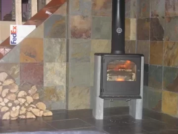

Very interesting discussion but I have a question about moving heat between different floors. My stove is in my basement and I am surprised how much heat I am getting on my top 2 floors with a small fan pointing up the basement stairs (hopefully I can get my picture to print. The fan is two steps up from the FedEx box [guess I need to work on my photo composition skills]). To try and improve things this year, I have added a bathroom fan above the stove and vented it into the hallway to the second story.
After reading the prior posts, should I turn my fan around to push air down the stairs or is the fan already high enough to be moving warm air up? Thanks!

Wendell, that's a very nice looking stove. How's it working for you? It's placement right by the stairs probably is ideal for convecting heat upstairs. How well does it work with no fan running?
Just for yuks, try moving the fan to the top of the stairs and point it down the stairs, at an angle, towards the wood stove. That should make the fan act as an assistant to the natural convection of heat up the stairs and cool air replacing it. Changing the fan direction may or may not make a lot of difference, but I'd be curious to hear what you find out. My guess is that it will moderate temps in the basement if nothing else.
Thanks. I am really happy with how the tile worked out, especially for a first timer. Plus it gives me a lot more thermal mass to hold the heat during the night. I know many people say you shouldn't put a stove in the basement but it is where I could get access to the existing chimney and due to the layout of the house, the only place where I could get it centrally located. I tried to get a stove that wouldn't over power the basement but still be big enough to get heat upstairs and for the most part succeeded. The soapstone really helps, too.
I do get heat upstairs without the fan and now with both the fan on the stairs and the bathroom fan above vented into the hallway going up to the second story, I am able to heat the whole house exclusively with the stove as long as the temperature outside is above around 10 degrees.
I turned the fan around and put it at the top of the stairs. I will let you know how it goes.

UPDATE: I did turn the fan around and put it at the top of the stairs but unfortunately this corresponded with our latest cold snap so I don't know that my results are very scientific. Taking the temperature into account, i would say that turning the fan around certainly didn't make things worse and probably has helped to moderate the temperature in the basement.
And with the bathroom fan running above the stove, it certainly makes sense that there should be a "return air" fan also running.
Which brings me to a question about the bathroom fan. I just started with a 50 CFM cheapie to start with to make sure my idea worked before I upgrade to a 100+ CFM fan of much better quality. When the stove is going strong, it is definitely moving some warm air to the second story but once the stove gets to the last 1/3rd of its cycle before I reload, it is moving rather lukewarm air.
So, my question to all of you who are wiser than me, am I robbing Peter to pay Paul? I am moving some warmer air two stories up which is eliminating the use of the space heater up there but is the electricity I'm using to run the fan 18 hours a day negating any savings?
