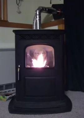

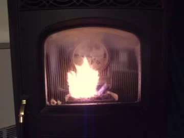

You are correct, there were a lot of dust bunnies and it looked like it was never cleaned before. However, the installer (he also services these things and is a Harman trained person) was on the ball and took everything apart for cleaning before rolling the stove to its place in the house. This allowed me to thoroughly clean everything according to his instructions. I vacuumed dist bunnies, cleaned out fines from everywhere they collect, cleaned the heat exchanger, etc. This thing started its new life in very clean shape.
Here is the picture of it going. Sorry for the quality, it's not easy to take pictures with a bright flame in it.

Congratulations !!!! Great looking stove.
IMHO, it was a good move getting an installer that knows these stoves to go thru it.
