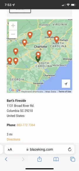

SC has one BK dealer. Fuel cost are way up. It’s high but down south there is just not much competition. Mountain areas are very developed with lots of higher end vacation homes as are the coats. Couple that with not many choices for reputable retailers/installers I’m not surprised by the quote.
There are cheaper inserts that one could choose. Labor won’t change, unless you DIY it.
