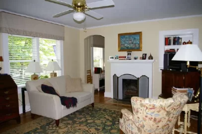

Can you provide a photo of the fireplace and/or drawing of your layout?
Here is a photo of what I am dealing with. I am certain that I will need something on which to rest it to give it the room it needs. As you can see, it's pretty a small fireplace. That is not our furniture, btw. This is from the listing pics.

What are the dimensions? Especially the width and depth, you got plenty of height there.
Oops, I'm sorry are you not going the insert route??( jusrt reread original post). never mind the dimensions then.
Looks like space might be at a premium, as the living room looks fairly small... Sitting a stove in front of the fireplace will require a pretty substantial hearth and intrude into the room quite a bit. I'd consider looking at either an insert or a stove that you can fit partly into the fireplace. You would still need to extend the hearth, but not by as much, and would have less to have to walk around...
