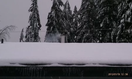

Here is mine with ice when burning the heritage non-cat which sent huge amounts of heat up the flue. My flue temps are now 50% of what the heritage wasted so I expect even more ice.
  • [Hearth.com] Ice on the cap...

Also, there is the possibility that the water which forms this ice is from precipitation perhaps falling as snow and then melting on the cap, running off, and forming icicles as it drops. You'll notice in my photo that I had ice on my gutters too.
