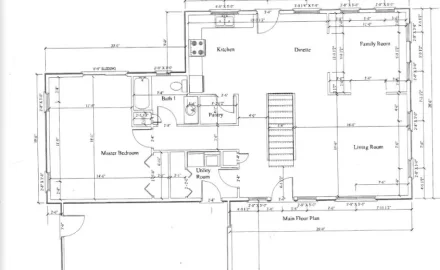

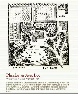

This is a plan that we started with, then altered to suit.
Cape cod styles were meant to be added on to, so we added to the left side.
The so called screen porch is now the "family room", where the stove is, and comfy seating. The kitchen, dining and parlor all get radiant heat. The bedrooms get less heat and stay cooler, which we like. It's two story, which makes it easier to heat - heat rises. South exposure, lots of south facing windows, with large overhanging eaves means winter solar, summer shade.
Not sure if this would be considered ideal, but it's close enough for us.
Reactions: Max W
