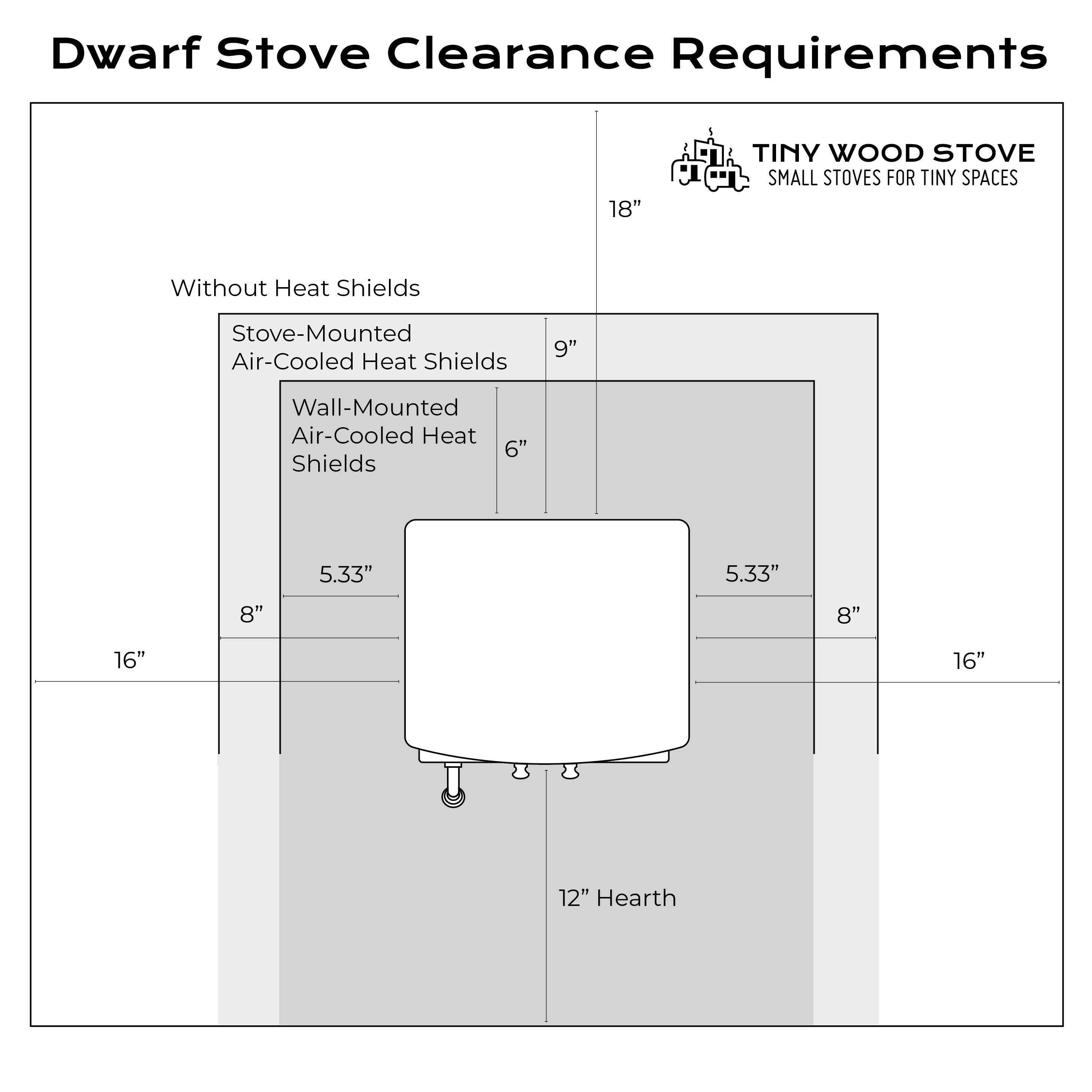

Heat Shields for Clearance Reduction In addition to using proper materials, adequate clearances are one of the most important safety features of any wood stove installation. A properly installed and maintained wood stove can be one of the safest appliances in your home. But cheating on...
