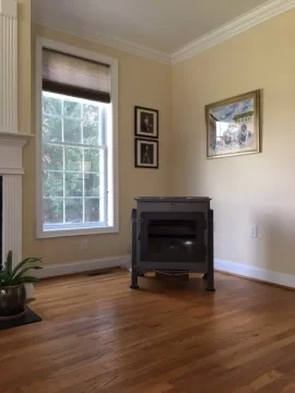

My stove finally arrived in February. Just recently got in the house and trying to decide on one of two locations. Stove will fit in nicely with my interior only thing is there was an error on the door color so that will need correcting. We've placed it in the corner to see how if it fits. Plan on getting the heat shield to reduce back clearance to 6 inches. Side clearance is 16 inches. In its current location it is 16 inches to the wall on the right and 21 inches to window sill to the left. Would the window be a problem? We have honeycomb shades we drop at night -and those are about 21 inches to the closest point on stove. Looking for feedback. Of course the pictures will be removed.

Is that a fireplace to the left?
As long as the blinds are beyond the required clearance to combustibles then you will be fine. No need to removed the pictures either..
It's is a gas fireplace. Which is going to be removed and is one of the two places I have to work with. With our layout I prefer stove in corner tho.
good to know about the pictures thought that might be the case since we plan on having the pipe exit the rear and straight out vs. up through second floor.
Out and up eh? Too bad you won't consider running up through the second floor. All vertical is superior for several reasons. The IS stove has been known to be draft sensitive and puke smoke out of the inlets into the room when draft is not great.
