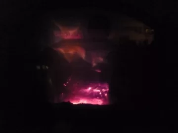

When I burn them I let the front catch fire and providing that the cat is already within the active temp I'll close the by-pass, the key is catching the bricks at the right time before shutting down the stoves air, that's why its recommended to only use a few bricks until you know how your set-up reacts to them since its a ultra dry fuel source.My question is should that be the practice with bricks?
To hot of a flue temp is anything above 800 deg, although there times that you get temp spikes.At what flue temps is over firing a concern?
