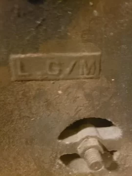

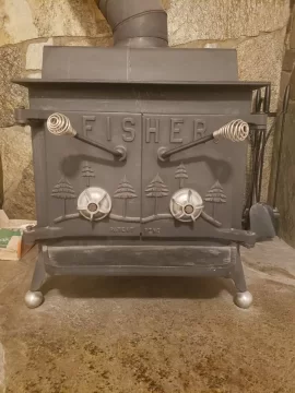

Hello, I moved into a new home and have noticed a fisher stove I was intrigued to find that these stoves are no longer made. I have the concern that maybe the stove is a knock off. But was wondering if someone could help identify the stove to see if maybe it is truly a fisher stove.
Any feedback is very much appreciated.

It is a Fisher coaly will be along to I'd it soon. Have you had the entire system inspected?

If that stamp is on inside door I think it indicates Left, Grandma. Once coaly chimes in he'll give best info.

Welcome to the forum, and thanks for posting the pics of your stove!
It looks like an authentic Fisher Grandma Bear from the pics. The center trees are farther apart on the Grandpa Bear.
