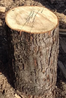

..then this is the highest BTU wood around!
[Hearth.com] If splitting your own wood warms you twice... (Wood ID & Stack pics!)

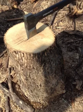

Can anyone ID this demon species? It's like it's designed to catch ax heads, compressing without splitting, despite lining up my swings with radial splits in the cut ends. I have 23 rounds like this one, and they're going to wait until I can get a hold of a splitter or winter comes and they freeze solid. I've split a couple with the ax, but only to see if it could be done. One round split after a dozen or so whacks, but refused to be quartered. There's a second species with darker bark but the same bad behavior:

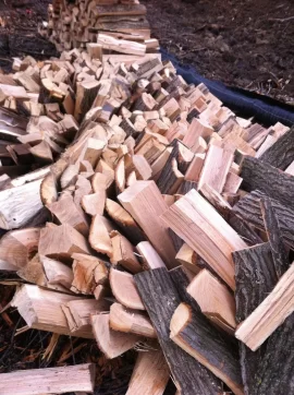

I had considerably less trouble with other species, and before the wood started to thaw out:

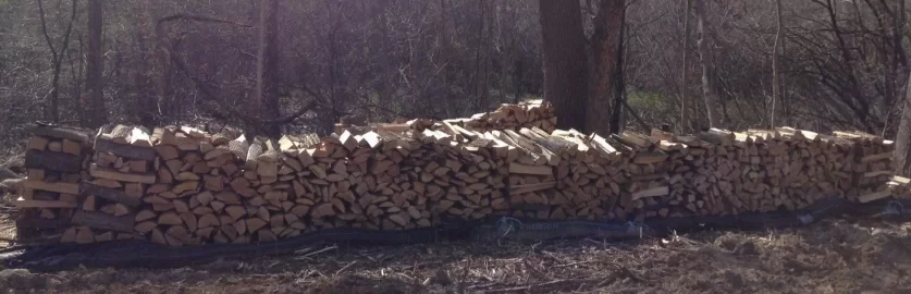

I figure it's about 3.5 cords and should last us the first winter. Most is cut to 19-22" long. There's two rows in the foreground and a bit more in back.All split with the Fiskars and cut with a Stihl 032AV ("Made in West Germany"). I've no idea what I have stacked up, but it's clear from splitting it that there's a variety of species. Some is unbelievably dense, which I suspect may be oak that'll have to be sorted out and saved for another year. My favorite is the dark-centered wood that never fails to split in a single swing.

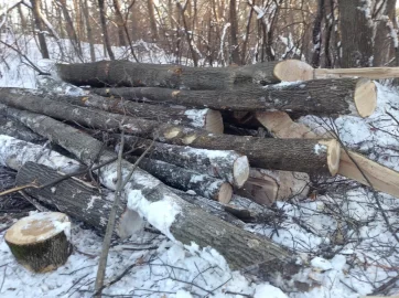

Two and a half months ago I started with a pile of logs left behind after clearing half an acre for our new home:

I see ash in the first pic, and what appears to be red maple in the second pic. Both of those woods should split very easily. I'm betting you are having trouble splitting them because they have knots in them (I can see the knuckle on the side of the ash round in the first pic). When I get a round with a knot or overgrown 'knuckle' in it, I flip it upside down to split it (put the part of the round that would have been facing upward when the tree was standing on the ground). Makes splitting knotty pieces a LOT easier, IMO. Also, try to line your axe up with the knot, so as to split the knot itself in half.
Also, for the harder-to-split rounds, you may want to consider a maul.....it'll make those denser or knot-infested rounds a lot easier to split.

Nice stack.
Have had them fall over from wind, earth quakes, frost heaves & just poor stacking on my part.
Yep, 5' high is difficult to stack & stay stacked :)
Gonna be ahead with the wood from the beginning, very good plan ;)
Wood ID;
Ash & maple

It sure looks like Ash and Soft Maple to me as well.
Huh. To me, looks like the same stuff in pic1 and 2. :confused:
