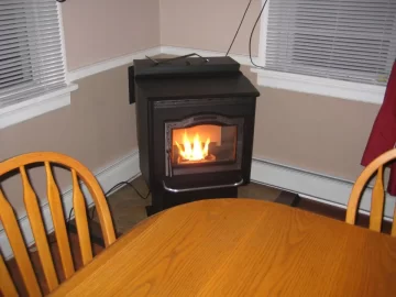

mine is not across the corner, it's straight in the corner, wall on left side, open on right side, makes a big difference for side clearance
Enviro M55 Cast.

rich said it was not a corner install

How much side clearance you need? The P61 and 68 need huge clearances, but the P43 is not so much, especially if you get the side panels. A corner install only needs 9" clearance from the back of the stove itself (not the back of the hopper), so that is practically zero clearance (although you need to think about needing to clean it). My P43 takes less space than my Hastings did all told.

10" clearance with side shields required. I have the side protectors and about 11" clearance to the side for my P43. I put up the separate wall protector only because I'm paranoid. Wall protector just leans against the wall with a slight air space - the wall stays cool to the touch.

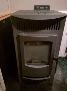

right now Bogie I got 7" with the serenity which is manufactures min., but the exhaust on the Serenity is off to the left side of the stove I can move the exhaust to the right a bit and up or down a bit but the stove has to pretty much stay at the same place,It comes down to stove width and exhaust location coming out the back of the stove,the harmans pretty much all have the exhaust coming out the center of the stove which with the width and side clearance is the issue.The Serenity is only 18" wide and the exhaust being on the left side only gives me a small window of movement.To the right of the stove is a window I got the be careful of clearances also.

rich, it sounds like you have your stove shoved in a closet ! LOl

Oh I do but looking at possible options for down the road and heck it's been pretty dead around here so it gives a topic of conversation
