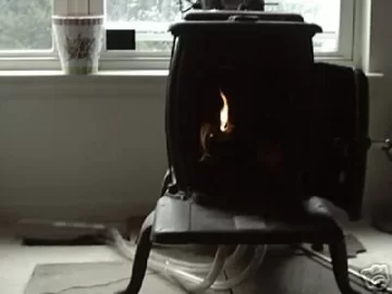

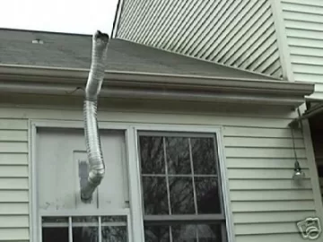

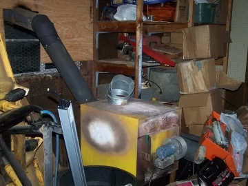

You are looking at alumium dryer vent Because it drafts so poorly, note the third picture. The guy cut holes in the bottom and inserted plastic air injection tubes.
The other end of the tube are connected to a blower. Esentually he has created a blast furnace using plastic tubes. It heats his entire home and really throws of
heat when it is glowing cherry red. The easiest stove he ever had to start and keeps on cooking. It can be run without the blower, but it puffs smoke back into the home. It is hard to start
and keep going.
Can anyone guess the manufacture of the stove?

elkimmeg said:
you are looking at alumium dryer vent
Quit showing that Elk. I told you this is the last year I am going to use it.
Wow....now that has Darwin award nominee written all over it.

Yikes. The pictures Elk posted are damned scary. To think someone would even fathom that was fire worthy is beyond me... and yet the 3rd picture proudly shows the fire going.
Elk what are those 3 tube like things under the stove? EDIT: Nevermind, I see you've elaborated on the pictures. Thanks.

ELK: Can anyone guess the manufacture of the stove?
Must be a New Englander, or some such, Maye a Harmon or PE- Elk tells us a Vogelzang would never take that sort of abuse, so it must be a good stove.... %-P
and keep going.

Well It looks like that guy was doing his own electrical work too with that FULLY ADJUSTABLE floodlight outside (in first pic).
and keep going.
I think it begins with a V, but realisticly, you can't blame the manufature of a bad stove for the bad setup the guy put in is own place (I'm guessing even in their manual, that would not be an acceptable setup). He's obviously looking for trouble there, but probably would have done the same type of setup with any type of stove
I especially like the plastic air injection tubes, LOL!

Harley said:
and keep going.
Yeah, but would one of those cheesy american made VC stoves stand up to that kind of abuse w/o a meltdown? :-P
I'm only half kidding, as while the setup shown is scary as it gets, the fact that the stove has apparently been severely overfired on a chronic basis without doing the China Syndrome says it can't be 100% garbage... Maybe they ought to use it as an advert - "don't do it like this, but isn't it neat to know you can?"

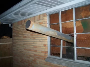

I know I am going to catch ALOT of hell for this but I will post it anyways, here is how I had my wood furnace vented in the garage until my insulated doublewall flue kit came and then I ran it through the roof to code, this was just for the weekend so we could work on plows in the warmth back in novembers cold streak
