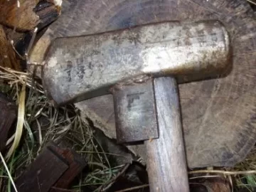

I've had this 8# guy about 5 or 6 years and it's had its share of abuse. If i ever see one just like it
i'll buy it for a spare : )
  • [Hearth.com] I'm at wits end! I need help, third maul split after 1/2 hour.

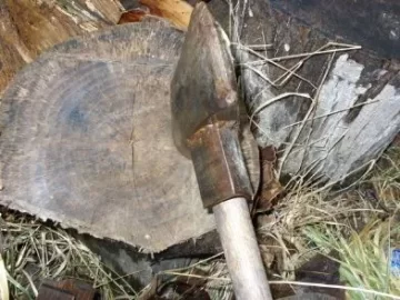

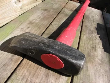

some times when you split , the split or crack dosnt come straight across the wood , so this is how i save my handles . weld a piece of 2" angle that you have squeezed together in the vice .then weld it to the bottom of the wedge. hope this helps .. hoot
