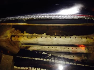

This photo of my outer most gas tube might be helpful. You can see the metal tab sticking out in the upper left corner and you can see that the baffle and blanket is not directly above the first gas tube. If this tab is not a guide for the baffle, then I am not sure why it is there. Will be calling Buck in the AM :)

My guess also would be all the way back and only allow the heat escape up the front of the stove. That is how my buddies and mine are. Mine came with a ceramic fiber board and his came with your set up. He bought his used and the metal baffle was warped pretty bad so we took it out and pounded it flat. Maybe yours is really warped that causes it not to cover the first tube. On his we have since replaced it with a ceramic fiber board we have outsourced and this actually makes his fan kick on waaaay sooner as it keeps the box hotter.
I agree, I think it should be back. You want all the smoke to be burned up in the tube area, not escaping up the back. But yeah, call or email Buck to make sure. They are very responsive. Manual didn't say anything about it?
The baffle sits directly on the tubes with no air space. Also, the ceramic fiber blanket sits all the way rearward on the plate.
After a few cycles the (plate will curl up like a big smiley face. :) You can also contact your dealer for a Model 21 baffle board (next year and boost the combustion efficiency by ~ 10-15%
Fireshoppe, Yes, the plate is starting to smile. I thought that maybe I overheated my stove already and ruined the plate but curved baffles seam to be common on this forum. Thanks for the advice on the Model 21 baffle board and baffle/blanket placement. The Buck 18 is my first stove. It only has a 1.3 cubic ft box but that little guy is keeping my entire first floor (2,500 sq ft) at a comfortable 73 deg. My heat pump for the first floor never runs. The upstairs heat pump cycles much less often when the stove is cranking.
