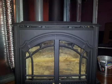

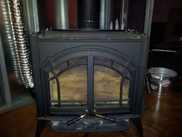

So, here are a couple of pics with and without the cast-iron top.
I have a 3 vids also to show what I described regarding the burning at the bottom. It is happening pretty much even an hour after the primary has been closed all the way...it just won't go any further, so I'm thinking that maybe the Gap allows is still allowing a little air coming through the bottom and not just through the secondaries. I checked for air leaks along the ash pan and nothing.

I don't own a Gap, but I thought I would chime in anyway - how about putting that magnetic stovetop thermometer on the face of the stove in the upper left or right corner. While it may not read as hot as on top of the stove, it would still give you a repeatable, reliable temp to go by and know how hot the stove is running. With a little experimentation of having that top plat off, using it to get a stovetop temp, and then moving it to the face you could fairly extrapolate your temps.

Jeeper - Thanks for the words of encouragement. That's a great idea about the stovetop thermometer on the face of the stove and comparing with the top and flue thermometer (my flue thermometer is a probe, so I'd have to pick up a magnetic one...good excuse to buy one now).
