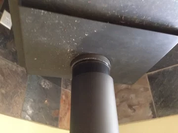

The hvac guy who installed my stove (Lopi 1750) is a good guy, but admittedly doesn't know much about stoves. He left the outer wall of the double-wall about 2 inches short of the flange because he said it doesn't fit over the flange on the top of the stove. I'm assuming there is an adapter that fits over the flange and into the double wall? He says he doesn't know the brand of the pipe ("but they all pretty much work together"), and I don't see a sticker or name on any of it. Here's a picture if anyone has an idea:

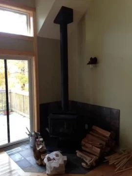

Also, he's willing to take another whack at the install. It's straight up through the roof. Could he do anything that would let me clean it from the inside? He said other than putting a 90 with a T in it that I could open and clean out, he doesn't have any suggestions. I don't have room to put a 90 in it. Does anyone have any suggestions that would let me take it apart and clean it from the inside? Here's a pic of the whole thing:
[Hearth.com] I'm looking for some help for my installer

The first pic is a red x :(
I am thinking I know what happened but I'm not sure. Inside the stove there's a little tab that sticks out where the pipe will fit in. Our installers notched the pipe in that spot so it will fit down in. I wish I had pics. But the short answer is that the pipe should sit all the way down onto the top of the stove, imo. Ours does.
you probably need a stove adapter for the double wall pipe, the place you got the pipe from should have this part- they are needed about 1/2 the time...
and yes, it can be cleaned from inside if you remove a baffle brick and have flexible gear like a Viper or sooteater, and dont have a screen that needs cleaning on the cap...

Is there a telescoping section on the bottom? It isn't too hard to slide it up, tape a bag over the bottom, and use a regular brush and rods.
I'm confused by this statement. The upper pipe segment must fit down inside the lower pipe segment, not the other way around. Similarly, your pipe must slide into (not onto) the stove outlet. Think of condensed creosote or rain running down the inside wall of your flue pipe. It must not leak out at the joints.
I'm assuming he must have trimmed it off, but who knows. Here's what it looks like: (I'm not sure why it's inverted)

It is double wall pipe. The top is crimped so it fits in the outer wall of the bottom of the next pipe. The inner bottom fits in the crimped top end like it should.
Not sure what is in that pic. It looks like the outer part of a telescopic section, mixed with a piece of single wall?

Do you think it's possible he cut the outer layer off the double wall? I don't think it's telescopic - he didn't think telescopic double wall existed... and if it had been telescopic, I think it would have just slid down and we'd be done!
It looks like a piece of 24 gauge black pipe stuck into the flue collar, he has tried to make an adapter himself. You don't want to hide a piece of black pipe in there, it needs to be stainless like the interior of your double wall pipe. You need that stove top adapter and a telescoping piece. How does he plan on making that final connection to the stove? Somethings gotta give here! Make your life easier and get that slip section.
If your roof is as steep as it looks, you would likely be money ahead to pay a sweep to come out to clean it. It can be done with a Viper from the inside, as long as you know how to put the baffle back together.

By the way, How seasoned is that wood in the picture? It looks pretty fresh split.
Looks like he slid a telescoping section apart, and replaced the bottom with a piece of single wall. Probably because the dsp wouldn't fit the flue collar.
The bottom of the shorter (outer) piece is sharp, like it was cut. Until I had him back out, he thought he was done -- he wasn't planning on doing anything else.
I'll get the telescoping section and the adaptor. I'm hoping I can slide the telescoping section up and clean it without taking the baffle/bricks out of the stove.
The wood is from last fall -- I'm doubtful it meets the Hearth.com moisture test.
Maybe that's what it is, but he doesn't think telescoping double wall exists. He told me that himself yesterday.

I don't think that section has been cut, it still has the pre-punched holes in it. Unless he drilled it?
