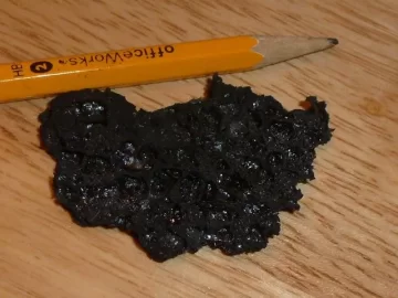

I was up on the roof, cleaning the gutter, and saw this in the gutter. I knew immediately what it was, and indeed, there's much more on the underside of the chimney cap. This fragment was part of a 3" x 6" sheet (I tried to light it on fire to see how flammable it was.)
[Hearth.com] I'm not burning the Oslo hot enough
I've been slowly learning about how to operate our two stoves, but it's been hard to break from the habits I formed while burning in open fireplaces. I really do think I am learning my lessons, which are to pack the stove much more than I had been, pay better attention to the air, pay better attention to the room and stove temps and NOT the flame, and then either let it cool down, or pack it again, instead of being throwing a split or two on at a time, poking along.
My questions: should we get it cleaned now, or just finish the season and then get it cleaned? Can I reverse some of this with really hot burns? How bad is this shiny black sheeting, compared, say, to the powdery soot I see coming out of the Morso chimney? Is it possible to "preview" how much creosote is in the flue by using a fiberoptic camera? I have been tempted to buy one on eBay. Thanks in advance, my experienced friends.

With evidence like that, I would definitely want it cleaned now to make certain there aren't other surprises.
Also, if you are closing things down on a full load, and this is happening, I'm concerned that your fuel may not be dry enough, as with a modern stove and good fuel, it should still get up to temp and prevent this sort of buildup.
At this point, I'd almost rather or recommend you putting smaller loads in and leaving the air open a tad bit more, yet still letting things run in cycles, not reloading until you need the temp increase, or are about to lose the coals are OK with the house being a little warmer than you want just to keep the fire going rather than restart.
Are you closing things down so far because leaving the air open a tad will mean things get too warm in the house?
pen
Pen of course makes good points. An "airier" fire with smaller splits may be in order. You should inspect and possibly sweep since burning some hot fires will not get rid of that stuff up near the cap, it just won't get hot enough and that's not really how to approach the situation any way. You want to burn hot enough all the time to prevent creosote not burn hot now and then in an attempt to burn it off.
Inspect and determine if your whole system is gacked up or just near the cap. FYI Once the cap gets starts getting clogged draft slows which further clogs the cap which slows draft which... any way things can go down hill quick.

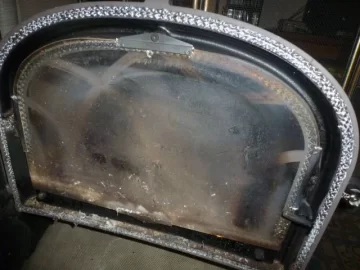

How often do you clean the glass? What is it's appearance between cleanings? Grey / Whitish soot on it that wipes off easily with a damp rag? Black buildup that takes scrubbing?

I haven't bothered to clean the glass yet. Here's what it looks like now:
I just now cleaned most of it, it cleaned easily with a wet paper towel, EXCEPT that glaze on the right, which will take some scrubbing. There are flakes of black creosote on the inside of the stove too.
According to what you posted, your wood moisture readings are pretty OK. It may be just a matter of sending some more heat up the chimney. Thermometers are mandatory IMO. And I try to read the flame so to speak. So no dark orange black tipped flames, bright yellow and lively, as often as possible.
