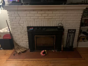

Hey all,
Back again with hopes and prayers that this is the year we finally get a functioning wood stove.
I had posted a thread similar to this before but with a different question so I figured I would keep this brief.

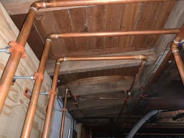

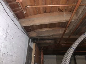

I want to replace my insert with a new woodburning insert. Our current hearth has plenty of space for an insert, however, the problem is the builders of our home back in the 1930s left the wood form under the heart which is a big no-no.
My question is this, is it going to be easier for me to just pull up our current tile hearth and lay down some micore, then recover with tile and make a lip. OR do I try to remove the old wood form from under the hearth.
I'm thinking the micore will be the easiest route and I'm thinking the lip wouldn't be too gigantic from the added material but I would love some input. If I go with removing the form I'm guessing I'd need a structural engineer to come in and confirm I can remove the form without risking the integrity of the house? Then I would have to actually remove that old form that is perched above my pellet boiler.

I think it's unlikely that an engineer would be required to approve the form removal.

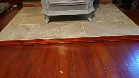

What R-value do you need? If it were me and I weren't too attached to that specific tile, I'd probably just leave the existing tile, add a layer of micore, and then re-tile it with new tiles (tile is usually pretty thin, so this shouldn't wind up being much thicker than if you remove the one tile). I did a similar hearth expansion, and three layers of micore, one layer backer board, and tile was just about the perfect thickness to put a standard door casing trim around the whole thing (I stained it to match the floors). I think it looks nice without being intrusive, and I've yet to stub a toe or trip on it.
That said, are you limited on fireplace opening height? If you've got a couple inches to play with, that's one thing, but if the insert is running up against the limits of the fireplace already, you might have to go with removing the forms.

Do you have an insert picked out? Personally taking out the tile would be my choice. The job may take a bit longer but you would get a chance to pick new tile. Demo above your head is never fun and working around pipes isn’t either.

I would love to see a photo of what you've done, if that's possible. If I do go the tile route I will probably just pull the tile as it wont be too much work, I have the time and would prefer keeping the lip as small as possible. I have plenty of vertical space in the firebox which is great. The WinterWarm insert I have was already huge and I have probably another 3-5" of space above that if I recall correctly. Been a while since I last measured.

This is what mine looks like - the lip is 2 1/4" high. It's just over R 3, which is probably more than I'll ever actually need, but it worked out with the size of the trim and the amount of micore I had.
