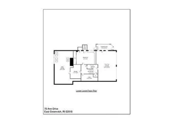

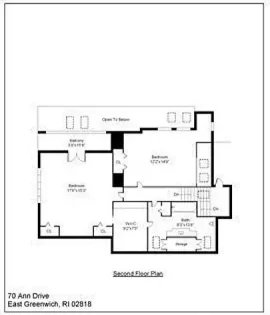

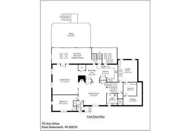

I will attach a couple of pictures and blueprints so all of you can see what the general layout is. It's a little over 2200 sqft, currently we're heating the home with oil (Rheem 85% efficient 140000 BTU/hr) in sub 35 degree weather and a 3 ton Seer 13 Heat Pump if temps are above 36 degrees.

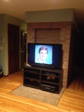

So now that you know a little about the house onto my question. The hearth size is 52" wide and 42" deep. The brick hearth is located in the center of the house, and it has a brick chimney that it goes up against it. I was looking at the Harman TL300 and the Regency 2400 as possible contenders for this house. I believe both require a minimum of 48". So, do they sell any hearth extenders that would match my hearth design?

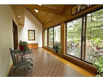

Also note that the sun-room is currently 62 degrees. It's separated from the rest of the house with insulated walls. My plan was to get the stove up and running in the living room and any of the excess heat would go into the sun room via the open french doors.

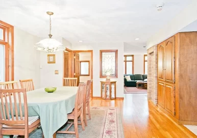

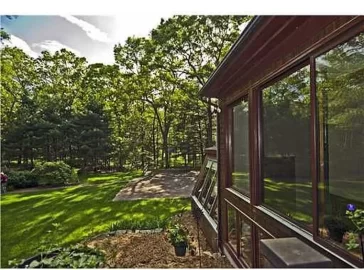

I appreciate any input into our heating situation, anyway onto the pictures: (These are the pictures that the sellers Realtor took August of 2012).

Was looking at the realtor photos and couldn't really see the hearth area. Might be helpful to take and post a pic of that area to better understand any potential issues. The Harman is nice for putting out even heat like a catalytic stove, but can be difficult to run properly for some users (especially with marginal wood), just so you're aware. Others have no problem and love it. Also the combustion package has been reported as fragile and is expensive to replace if you damage it.

Here is a picture of the hearth. Obviously, the TV and TV stand will have to be relocated. (I hope the picture works)

For whatever reason the hearth picture didn't work, lets try this again.

Question: Are you going to block off the fireplace and then add a new thimble at the 4-5' level? For a simpler install, have you considered a big insert instead?
