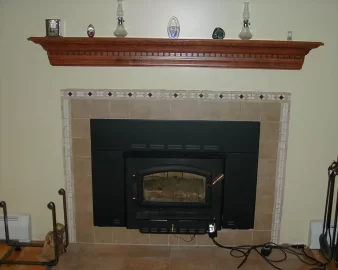

I used to have a Quad 2100i which they don't make anymore but it looks like the 3100i and it extended out on the hearth a little-I didn't have a fan on it and the mantle got pretty hot and I had it more than the minimum above it for sure.
Here is what my install looks like.
Thanks for the pic velvetfoot. I'm getting more confused by the minute. The reason is I looked at more stoves today. The 2700i so that it will be flush requires a fireplace deeper than I have. The 3000i depth is 14.125 in and it would just fit. The fire place is deep but it shallows quickly above 20 inches. But the insert that looked like it would fit best, from the drawing anyway, is the Hearthstone Clydesdale. It can fit as shallow as 13.375 but my wife's thoughts of flush mounting are out. My concern is getting cooked out of this room. It would be a giant stove loping along. Will it get hot enough to reburn? Is a stove with so much heat capacity a bad idea for such a small room?

Thanks all. Doing it correctly can take some time, had an issue or two. The only thing I'm not done is the mantle/deflector. But even then I think I'm leaving the fan, it's blowing toward the door anyway. It was just the break in burn but all seemed to go just fine.
Thanks all again, mucho appreciated.
