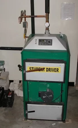

They don't need lots of space - each model will specify clearances, but they're not huge. You want a little space for servicing and a few days worth of wood if possible.
Here's a picture of my EKO 25:
  • [Hearth.com] Indoor Wood Boiler Vs. Outdoor Gasification
