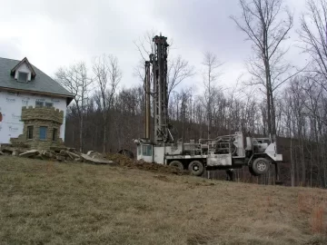

These wells are not open systems. The wells will have a loop of pipe dropped into them that does not inject or draw actual water from the well it only draws or dumps heat. The driller just doesn't want to get his equipment so close to your house, these are big machines that blow mud out and you need room around the drill rig.
My first geothermal well is about 25 or 30 feet from the house, then they're spaced about 12 feet apart, in a line leading away from the house. He might be concerned about the liability associated with your foundation. Someone tried to sue my geothermal installer to get a new basement, claiming his activities cracked it. I've read it is possible to freeze the soil within a few feet of the well, but it would have to be within 5 feet of your foundation I would think to actually disturb it. I'm no expert though.

It has been a long time, over 15 years, since my geothermal was installed. We have two 250' deep vertical loops. I'd estimate the holes are about 20' from the foundation.
