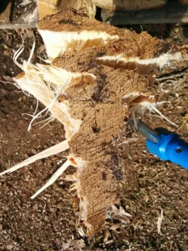

We processed two cords of sweet gum this weekend. It was the strangest splitting wood ever. It's like the grain of the tree is woven like a braided rope. When the wedge starts sinking in ropes of wood would tear out on either side of the wedge.
I don't know how you could possibly split it with any axe. I've even heard that it's harder to split when dry. Check out the attachment. All the splits look like ragged lightening bolts. Is there any wood that's more of a pain to split than Sweet Gum?

I only had one round of Sweet gum in my life, and I split it by hand and it was horrible, That picture is really crazy looking! I liked the way that it burned though.....

Your mileage may vary; I've heard from some folks that sweetgum splits better for them when it's green off the stump. I haven't experienced that ~ always left the rounds set a few months before splitting. Trying to split it green, all I got for my trouble was a mangled mess like in the OP's photo. After a few months drying time in the round it'll slab off the sides easily. The center is still stringy but it splits, at least.
