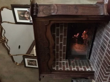

we have electric heat. I love the thought of having a perpetual, productive fire at the hearth during cold weather. 3000 sqft in TX. I need something that compliments my mantle (pic attached) and masonry. Lopi Freedom Bay looks great. Please provide me with advice!

That large wood mantel overhang could present a clearance issue. It looks like a big heat trap.

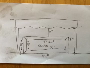

Will a blower help to push the heat past the trap? Floor of hearth to bottom of overhang is 36".
It is not just about getting the heat past the mantel but more about having the required clearance to not have it burn up some day. 11" mantel clearance will be really tough to get and there is often a max depth the mantel can have. Plus, your fireplace is wide but not that high. I am really not sure which insert would fit in there. Must be something pretty small but that would never heat 3000 sqft even in your mild climate.
