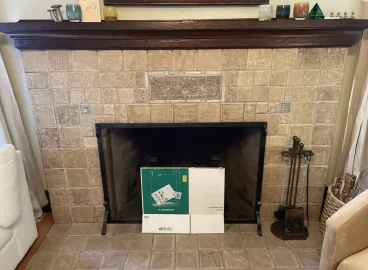

Thank you for the reply. House is several rooms - not an open plan. We want an insert, not a free-standing stove. Ideally it would be flush. Here is a photo of the fireplace. The box in front of the screen is for reference would be the size of the Regency 1150 insert - thus the backing plate would have to be big and unsightly :

I would pick a bigger insert and build smaller fires if needed. I have a similar sized house as you and ended up choosing a medium sized insert (ZC fireplace) for our fireplace remodel. And on our coldest days, I am noticing that we could have went larger. But I am in the Northeast and you have said your winters are not that cold. My first floor is mainly open and not so separated by different rooms.
But I am with you... I wouldn't want a huge surround to block off the excess opening.

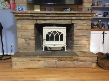

Could do like we did, an insert stove without the surround on it.
I didn't want to cover up the arched stone FP so I welded up a stand for the insert stove to sit on to make it look more like standard stove...which is the look I wanted, but with the blower in the front (for service access) like inserts have.
I have a blockoff plate installed to stop heat loss up the chimney cavity too.
This isn't the best picture, but you get the idea.
How large is the fireplace room? Is it open to any other room? If so, what is the combined area?

We went with the Regency Alterra CI1150 which I believe has a similar firebox size and BTU range as what you’re looking at. Probably a smaller square footage in a similar vintage home, too. So far no complaints with being cooked out of the room, but your mileage may vary with your home layout. I think we could have even gone with a bigger insert.
The standard surround is 40” wide and 29.5” tall I think so you would need something custom to cover your cavity. I think the standard size looks quite nice, but I could be biased because it’s mine.

With a hole that massive I'd personally be going for a freestander sitting within the cavity.

The main issue will be with the surround not being wide enough. This can be solved by adding a short extension to it or having a custom surround made. A good dealer can handle this. It's a common problem. This will help fit the Regency Ci1150 Alterra, and open up more choices like the Lopi Answer insert, Pacific Energy Neo 1.6 LE, or the Osburn Matrix. Most dealers will do this. If not, Kuma sells a good smaller catalytic insert, the Alpine LE, which qualifies for the tax credit, and they will make a custom surround for you at the factory.
