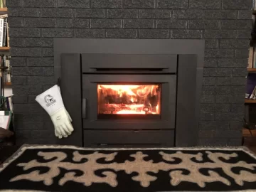

In central Wisconsin looking to have installed a small wood burning insert, such as the Regency Alterra CI1150. My question is: even with this small unit would we be cooking ourselves in the living room?
I’m in a small house which is about 650 sq ft on the first floor, has a similar sized unfinished basement, and has a finished half second floor attic. The hearth is in the center of the house but facing out into a small living room, about 120 sq ft. I worry about being able to comfortably sit in the living room and distributing the heat to other rooms that wrap all the way around the other side of the fireplace masonry. Would building smaller fires, turning on the whole house fan, and maybe constricting the fire box by putting in more fire bricks do the trick?
The wood burning insert would only be secondary heat source supplementing the gas furnace, which only ducts into the first floor. Currently we are heating the second floor with space heaters. The guy selling me the insert unit even said I should just go electric for the small space.
Am I just over thinking this? Worrying about nothing?

If the stove is on the 1st floor, it won’t heat the basement.
I think you’ll be fine with a 1.3 cubic foot firebox in around 1000 sq feet of house.
If it gets too hot, smaller fires will be easy to light in the small stove. It also won’t have a very long burn time. Be sure to install a block off plate and insulated liner.

A small insert should be ok if the living room is not closed off. Can you post a simple sketch of the 1st floor layout, showing the fireplace location?

Thank you all for your responses. I wanted to wait for some real experience burning in the insert before reporting back.
We went with the Regency Alterra CI1150 because of the small firebox for our small space, and also because it had a nice flush and modern look. We had a professional install with an insulated liner per recommendations from folks here.
Following the manual instructions, the first few burns were small, let to go all the way cool, and slowly escalating in size and temperature to go through the break-in period and cure the paints. The insert definitely gave off some fumes as it baked the first few fires, but it has quickly reduced to almost no chemical smell.
The fire box is small, but big enough to easily fit 3 large splits or 5 or 6 criss-crossed smaller splits. I've been getting the hang of swinging a new X27 so re-splitting has been more out of practice than out of need. So far we haven't run a burn that goes all the way through the night, nor have we gotten up in the middle of the night to feed but we will be doing that soon as the weather gets colder again.
So far the fires have been big enough to warm the living room, but have not had an issue with getting too hot in that room even though it's only 120 sq ft. The experimentation with air flow throughout the house is only just beginning and I think will evolve with longer burns.
Lastly I'll note that the first order of Supercedars just came in so about to start the first fire using those. Hoping they live up to the reviews from here!
If anyone else has this unit and wants to chime in on it's quirks or has questions about it, feel free to ask and I can try my best to contribute as a new burner.

I'm glad it's working out so far. We need pics, or it didn't happen. ;)
As requested:
