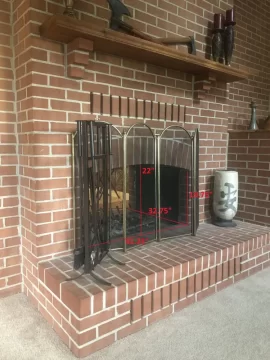

Greetings! After much deliberation a couple months ago, we eventually decided that it was best to wait on spending thousands on doing anything to our beloved fireplace. But then, we went to get the flue cleaned, and the chimney sweep discovered issues with cracked chimney tiles, mortar and sealant. Said we would need to repair in order to safely use the fireplace, and quoted in the neighborhood of $4k. If we have to spend money anyway, we figure why not spend a bit more and do an insert afterall. So, because we're working with different people than we were a couple months back, we're looking at different insert options, and I have some questions on which I'm hoping we might get input.

A photo of the current fireplace with measurements is attached, however the chimney sweep says our firebox is bigger than the brick opening, and we can remove the arch to fit a larger insert.

Second. Your dimensions seem like they will take almost any insert or the average size insert so that is a good thing. But is the depth of the fireplace the same as the bottom as it is on the top in the middle and sides of the arch?
Third. Is that a double sided fireplace? If so are you planning on blocking one side?

It is double sided, yes. When we first started a couple months back, we were investigating doing two inserts back to back. However, the concept is unfortunately cost prohibitive. New guy thinks he can close off the kitchen side in an aesthetically pleasing manner so that it can still be used for candle ambiance, etc.
The fireplace behind the brick is straight on all sides, so yes, depth is the same.
