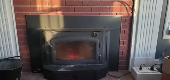

Hello - I realized this is discussed often, but need to replace a failing Regency I3100L.
I have a great deal of firewood cut approximately 18" wide, but a few are longer. The Regency I3100L can accommodate up to a 20" log.
Regency no longer makes an insert with a firebox of 2.9cu ft that can handle the size I have my wood cut to. The dealer says that he expects at best Regency to come back and offer a smaller 2450 in response to the warranty claim.
So I'm looking ahead and thinking I might be forced into another unit. BK Princess 29 and PE Summit LE seem to be candidates.
Two questions:
1) It appears the Princess 29 CAN NOT be chimney swept from the bottom up and that the Summit LE CAN BE chimney swept from bottom up. The chimney if about 33' and it would be an added expense for me to have it swept top to bottom.
2) Any other QUALITY candidates that could accommodate the cut log size I have, 18" average with an occasional 20".
Really hoping Regency stands behind the unit.
Always appreciate the help in the forum.

The princess can be swept from inside with a rotary cleaner. And the 33' tall chimney is the reason your stove cracked it was over drafting. I would have put a damper in one that tall.

Based on the parameters, I wouldn't put in an easy-breathing stove like the Summit without rigging a key damper above the flue collar.

I drilled the appliance adapter and through the liner. Removed baffle and installed with an extra fender washer between the liner and the damper because I had the spring version. Have a pic on another thread about a Drolet 1800. Search for insert damper and you can see how one was modified to extend through the surround.
Blaze King has very specific draft parameters for their stoves. Too strong draft can be an issue.
I will have to take pics of the next damper mechanism I make. It usually involves a couple u joints made for sockets and welding 1/4" square rod to them etc.
