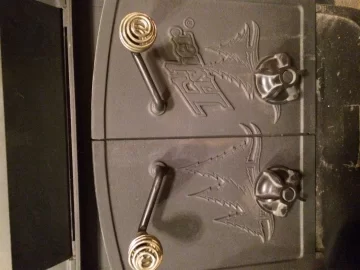

I've got a wiggly door latch on a fireplace insert. Looks like it has grandma bear doors. I think the person that was using it before me was forcing the latch over the top of the nickle protection plates, and it made the door latch loose. I put a gasket in there just to see what would happen, and it burned low overnight. The gasket is a fix, but it would be cool to get it back to original - am I looking at a new door or is there a way to just pull the handle/latch off? The whole stove is black, but it had those nickle protection plates so I'm hoping i might find nickle doors...

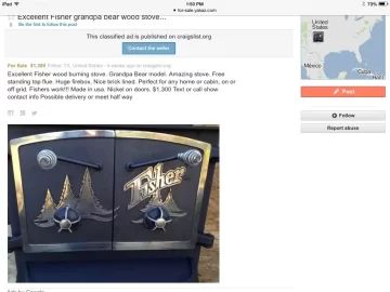

[Hearth.com] Insert sale question I've looked everywhere and can not find this model. It it grandpa bear lll and I just wanted to see I'd anyone can give a round about cause I don't wanna rob myself with the price since I'm buying another insert to pit in there when we take it out.
I nont know your market at all but around here $400 would be the top but more likely you would get $250 or $300

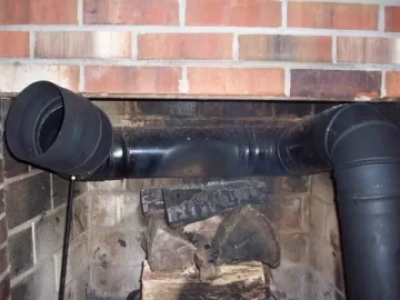

It has a like dryer pipe kinda going all the way up the chimney I assume??? I can only see a small area that makes it visible. What do I need to do to check the liner ? Might you have any pictures showing the difference? BTW this was the best website I could find and I've gotten more info from this site on the model and such than all others together and I looked up sites for a few hours lol. Thank you Coaly for your time and expertise to help me become more knowledgable on what I have.
You have to remove the upper face plate / cover to see the connection.
You're looking at a pipe that goes between firebox and outer shell that makes an air chamber around the back of insert.
Below you can see the double wall making the air space. You're looking into that slot at top, not at the top of Insert.

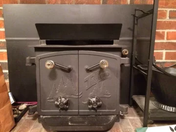

[Hearth.com] Insert sale question There is no collar that sticks up. The only way to connect directly to liner is with a boot or homemade adapter.

View attachment 155156 I've looked everywhere and can not find this model. It it grandpa bear lll and I just wanted to see I'd anyone can give a round about cause I don't wanna rob myself with the price since I'm buying another insert to pit in there when we take it out.
You're picturing a Fireplace Insert. No bear name given. A Grandpa III is a freestanding stove with 4 legs, 30 inches wide, arched doors with bottom and rear shields. The Insert uses Grandma doors.

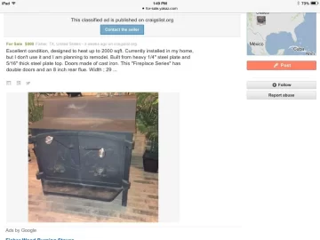

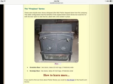

View attachment 155162 View attachment 155164 View attachment 155163 Ok I was seeing them go for wayyyyyy more but if I need to hold it till November./October to pretty much double my profit I would much rather do that. Thank you for your time and response bholler. So I was thinking it was worth 800 round about its in good shape it closes solid and also I have the back part that goes over the brick that I did not see included with these
Those are freestanding stoves that do not use a hearth enclosing faceplate.
They are not designed to sit back inside a fireplace like an Insert.
Also it looks like most of those stoves are listed in texas you are in va the prices swing greatly depending on the area. If you asked $800 for one in this area you would get laughed at you need to check craigslist and classified adds in your area to find an appropriate value. You can always list it for $800 and see if you get any response who knows.
