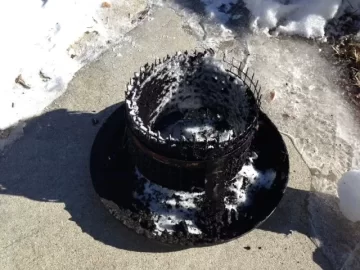

Today I had my chimney swept and see in the attache image how the cap looked like.
I wonder how could the cap get so clogged up in 3 months...........

Don't feel bad. I have seen that happen in a few weeks with green wood burning.

Once the draft begins to slow due to creosote formation accumulation accelerates and things go down hill quick. Good job getting it straightened out.
