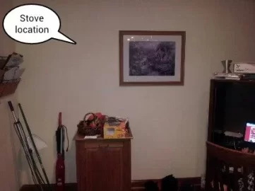

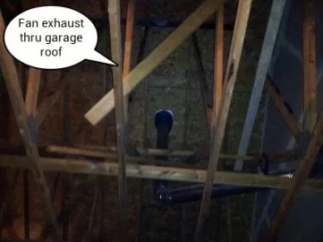

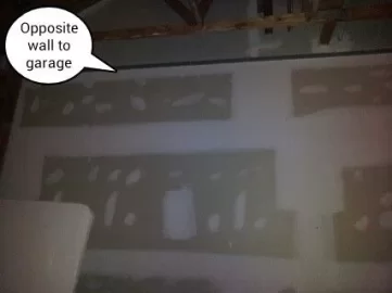

Well the boss has stepped in and completely changed the question. She loves the Heritage stove but she wants it on an open wall connecting to the garage.
I like this setup too but I know it will add around $1200 in pipe cost. What I don't know is, how much more in labor? The pipe would go up, T into/through the wall into the garage and up through the garage roof.

Anyway I dont know if these pics are at all instructive, but here they are anyway..

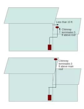

my bubble just got busted on the pipe. since the pipe would be within 10ft of the 2nd story section J understand the chimney must be 3ft taller than the 2nd story roof. any idea on how much a chase costs?

To transition the first wall, you will need Class A , then from that point to termination outside must remain all Class A.
Plus the thimbles and supports etc. I would guess that the $1200 is about right. In my signature link is somewhat similar install, but thru another living area, ceiling, then roof.
Clearances for Class A is 2".
If it does not go thru a living area where someone could reach and come in contact with the Class A, you do not need a chase, unless local codes or neighborhood housing association has rules.
Outside, same deal 2" clearance to structure.
Call your local building inspector to see if they have building codes that trump the standards And if you need a building permit.
Thanks Madison. to clarify on the outside, are you saying the Chimney can terminate lower than the nearby main section of the house assuming class A?
Top diagram?
Thanks!

It looks like I'll pursue running out a the back of the house, and up through the eve of the main roof. roof pitch shouldnt be an issue as I can get 10 ft horizontal clearance. Remaining question will be the cost of building a chase to appease the hoa. thanks again
