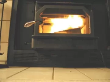

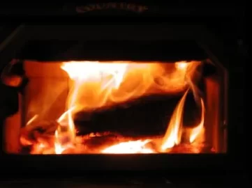

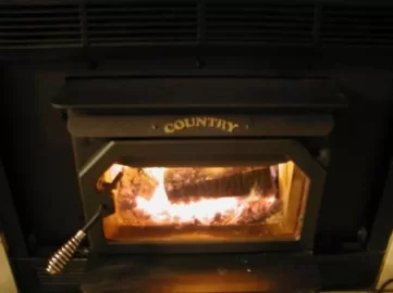

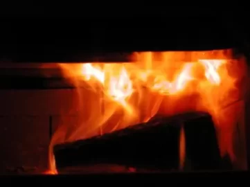

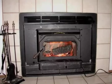

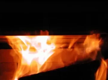

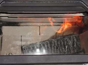

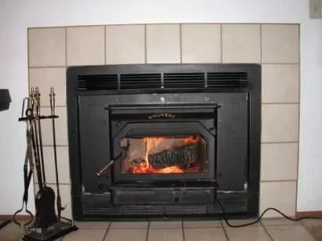

here are some pics of my Country C160 insert installed in my Majestic ZC box, according to Country this insert is approved for a ZC install and approved for a majestic ZC box, However according to MSG's 10 point list I am not legal, wich has me just a little concerned. here are my answers to MSG's 10 points
1) no- Insert is UL907 and UL127tested
2)no-no idea
3)yes
4)yes
5)yes ( front)
6)ok- not blocked
7)ok-in compliance
8)ok- not blocked
9)no
10)no
