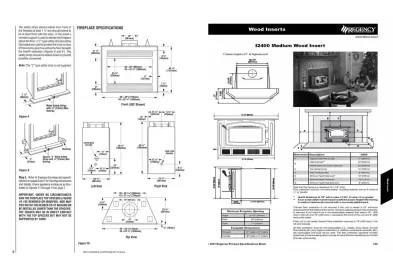

Thank you for your response. I have a question about lining up the flu pipes. The attached drawing is a cut sheet of the fireplace I have now next to the Regency I2400(I have the larger of the two sizes listed on the drawing). I can email this drawing if quality is poor. From the front edge of my fireplace the center of the flu is 15-1/4" back and 36-1/8" up from the floor of my fireplace. When I install the Regency the center of the flu pipe will be 11-1/8" back from the front of my fireplace and the top of the Regency will be 20-7/8" up from the bottom. So the horizontal distance will be 4-1/4" between center line of two flu pipes and the verticle distance will be 15-1/4". Do you think that I could get the needed fittings to make this install work?
Thanks again for your help.

(broken link removed to http://www.chimneylinerdepot.com/store/comersus_viewItem.asp?idProduct=64)
Would something like this work for my question above?
You should be able to get the liner & the flex-to-rigid (FtR) adapter into the top of the insert,
without any additional fittings...
You're going to have to get a fully wrapped (insulated) liner for the length that's within the
Majestic vent pipe due to the heat from the liner exceeding the safe rated temps of the existing vent
The hard part will be trying to get the FtR attached to the brackets on top of the insert.
The FtR is a fairly heavy gage Stainless Steel & you should probably use some drill pointed or piloting
screws to attach it, held in a magnetic driver in a screw gun...
You will probably have to fabricate a small metal or stone riser to support the
under side of the blower unit - so it looks good...

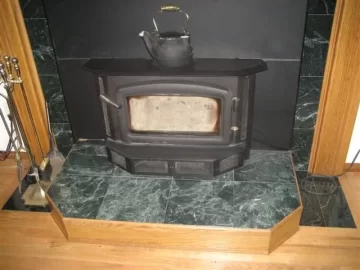

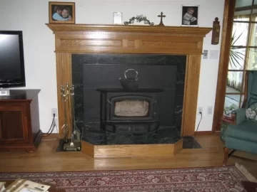

  • [Hearth.com] Install fireplace insert in prefab fireplace
