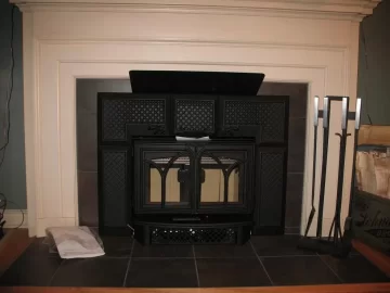

Post a picture of your set-up and required clearances. Which clearance is not meeting spec? We may be able to find a quick solution for you.
If the issue is clearance to the mantel, there are ways to remedy the issue. We'll need specifics, but hang in there, a solution is probably close at hand.

The clearance is from the ground to the bottom of the mantle. The install manual says that from the base of the hearth to the bottom of the mantle at 3.5" deep must be at least 37" with the heat shield. That is the lowest measure that they give. Mine measures 33" to a point where the mantle molding is 1" deep. At 3.5" it may indeed be 37" (I am not really sure how to measure this), but the install manual does not indicate that it is OK to skip the 1" molding.
A pic will help a great deal. I'm assuming the heat shield you're talking about is an integral part of the insert assembly. It's possible that installation of an additional shield beneath the mantle could solve the clearance issue, but I'm not sure I'm picturing it correctly in my mind. Not really sure about a lot of stuff that goes on in my mind anymore, actually. Rick

Here is a picture of the install. (at very least it is a sample picture with the Tamarack mantle shield)
The innermost molding is 3/4" deep and starts at 33" high
The next ring of molding is 1 1/4" deep and starts at 36 1/2" high

Wow, real nice setup...sorry you ae having so much problems, thats a bummer.
Is there any way you could jusr remove the innermost piece of mantle, and then perhaps remove a portion of just the top of the second piece?
Granted, you would nned to do some additional tile work to fil in the areas...but perhaps you have some tile let over, and you could clean up the second portion of the mantle with a router to make it look clean?
Such a nice stove, there has gotta be a solution for you.
Good luck!
Just looked at your photo s again. If you remove a portion of the mantle, you might be able to find a border/decorative tile with similar color to match the existing tile. (If you dont have any left over) I am not a handyman, but I have done tile a few times and its not that difficult to do..was thinking that perhaps you remove the mantle to meet the clearance issue, and then place either similar tile, or a decorative border to make up for the mantle...not a huge space, so the cost shouldn't be too much.
I would however make a big gripe to your dealer that came out and measured...I am one of those non confrontational folks myself, but after dropping more than a few large ones ($$$$) you have evry right to complain. Again, good luck with everything.
The first thing I do before starting a project is to measure everything out. Sorry, but the guys installing this should have been aware of the clearance problems before they put the stove in your house - takes all of 2 seconds to measure from the floor up. If the company doesn't subcontract the installation out, I think you have a good case to have them come and get this insert out... do what you need to do on the mantel... and get the insert you originally wanted set in there. Just my .02 cents.
