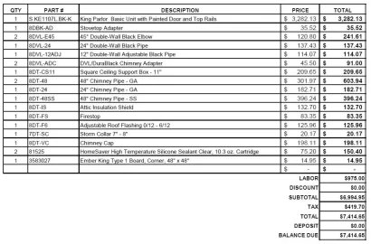

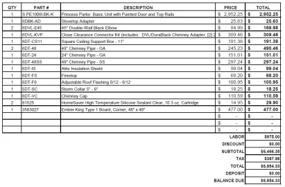

Hey guys,
I received a quote for both a BK King and Princess install along with Class A Chimney tear down and replacement. Need some input and feedback from installers or anyone else that has had similar work done. The quotes are fairly steep and I just want to make sure they're on par with industry norms before I shell out that kind of money. I know it's an investment that will eventually pay for itself but I'd like to cover my bases before pulling the trigger. I'd love to do some or all of the work myself but I just don't have the time right now and I'd rather pay someone who knows what they're doing and have it done quickly.
Any help/insight is greatly appreciated. Cheers!

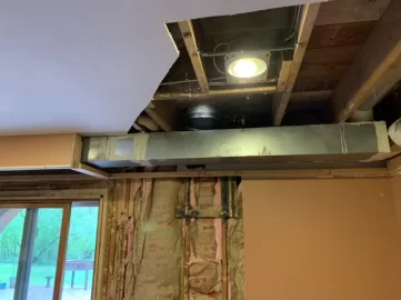

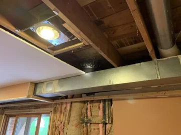

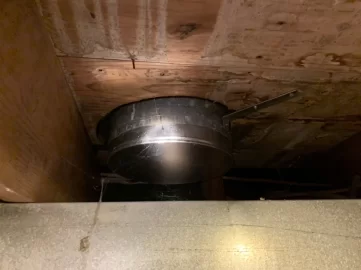

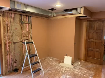

Also, because of the clearance on the existing chimney, the installer said double wall would have to be used for the stove pipe. Not sure how much clearance stove pipe needs. Here are some recent photos after I tore the drywall out. The HVAC ductwork is getting rerouted soon.

It's nice that they detailed out the parts completely. There are several obvious human errors in the quotes. Compare the same silicone sealant price between the 2 quotes ($150.40 vs $21.90). And there is a huge disparity for the Ember King type 1 hearth board pricing between the two estimates. Neither price seems correct ($14.95 vs $477) $477 is too much for a simple type 1 pad. Also, the BK King estimate calls for two DVL chimney adapters when only can be used.
Single wall stove pipe requires 18" clearance, double-wall is typically 6". BK recommends using double-wall stove pipe to keep the flue gases hotter.

Thanks begreen. I agree with the errors you have pointed out. I emailed about the crazy difference in sealant. I did some Googling and the Ember King pad seems way over priced for as bare basic as it is. I went to Woodland Direct and for just a few dollars more you can get a MUCH nicer pad. As for the chimney adapters, is that just a typo? It says it’s a “kit” so the price should be what it is, right? Don’t think they are quoting me for two adapters but I can ask.
Good to know about the stove pipe. Since it sounds like I need it anyway, that’s a bonus. I would have thought you wanted single wall to get more heat off the stove pipe and not up the flue. But I presume hotter flue gases help prevent buildup?
So other than the human errors, does the cost of the stove and the piping seem reasonable? I thought $975 for labor was reasonable considering all they have to do to remove the old one.
Thanks again.
The 2 chimney adapters are listed in the King estimate, not part of a kit. There should be only one listed. The piping parts are all retail priced which is fair. They have the cost of running a business to cover.
You want the stove producing the heat, not the flue. Hotter flue gases keep creosote from condensing and improve draft.

I was thinking aesthetically and to keep the stove further from the sliding door to place the stove in the corner at an angle facing towards the middle of the room. This would offset the stove from the flue. They have to use to 45’s to make it work and they’re still not sure they can because of the soffit. There’s minimum length before you can elbow I guess. The ceiling support box will already be low since it will go in the newly shaped soffit after the ductwork is moved. A straight stove pipe is an option but that moves the stove close to the sliding glass door and isn’t as aesthetically pleasing in my opinion. Would draft be an issue with 2 45’s from the stove to the flue? Thoughts?
Can anyone offer any advice on the proposed stove pipe with 2 45's? Can that create a draft issue?
Probably not as long as the total flue system height is >16'.

I'm also not seeing any double wall stove pipe on the princess quote.
