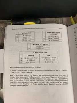

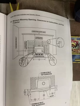

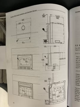

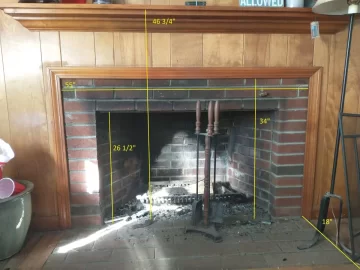

Forgive me for any forum faux pas, new to forum and joined to sort out some fears and hesitation with a stove install. Pics posted. There was a coal stove previously installed in this location with a hearth pad. The oak wood floor under the pad sustained heat damage/charring. The stove was set out a ways into the room and vented up through the damper with a block off plate in the damper. This was permitted, inspected, and approved by the town. I was hoping to simply mimick the previous installation with a wood stove but possibly have the stove set back into the fireplace a bit more so it wasn't jutting out into the room so much. I'm weighing my options here, the space is small, and so is my budget. Every stove i've looked at will have clearance issues in this space so I'm not sure how the previous installation passed inspection. What are my options here?
