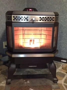

Ashley 5660, and it's working very well.
It kicks out some nice heat too ! Setting 2 or 3 and the ground floor is at 74.3 - 77.8F with the outside temp in the evenings / night at 25 - 28F.
It seems to be easier to clean as well, I like the ash pan that's under the burn chamber. I also like the two cleanout covers on the sides of the stove, easy to get to with the side panels that open for easy access to the stoves motors.
The stove is burning clean on all heat settings, no black soot on the glass or the back wall of the stove. Nice clean grey ash.
One small complaint, the manual that comes with the stove sucks, not even close with the instructions on how to use the controls, the manual for the Vogelzang VG5790 is more precise with details on how to use the control board.
Oh, forgot to mention, it's much quieter than the stove it's replaced (25-PDVC), I don't have to raise the volume on the TV anymore ! The 25-PDVC is going to be installed in the cellar in the new year, just got to work out how I am going to vent the exhaust / OAK.

Very nice looking stove. Great you are happy with it.

Nice stove ! Where did you buy it from ? And do get back in a few weeks with progress reports. One of these could be my new basement stove if it keeps kicking out heat for ya.

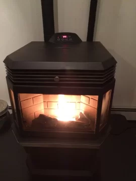

I have the exact same stove that I got hocked up a week ago. It does run good and heats my living areas nicely in the house. Been running on 3 and keeps house about 75 degrees. I did have 2 year old hamer pellets and somerset pellets in garage that I started with. They burn nice in the stove. I have a ton mix of both them from 2 years ago. Wanted to hold on to them till it gets a lot colder, they are good heat pellets. Have tried a few different brands so far. If you get a brand of pellet that has length to them, like over a 1" long, good luck' this stove seems to like the shorter length pellets. I got 5 bags of a pellet from my brother inlaw, they were eco blazers. There are long pellets of about 1-1/4 to 1-1/2 " long thru out the bag and the stove does not like them. Auger would moan a few times when it ate a long pellet and stove would pop, breaking that pellet in half. I tried them for 3 nights and every morning when I got up, stove was not running. It either throwed a E2 error or just shut down for no reason, with no error codes to investigate. So went back to hamer till I picked a bag or 2 of something else to try. Been using shorter length pellets under 1" in length, and have had no problems. Long pellets haven't worked for me. Trying some Nation's choice right know from lowe's, stove seems to burn them ok. Atleast the bags I opened, they are a short length pellet. Heat is not horrible, it is 73 degrees in house right know, which isn't bad. Just put them in today, so don't know how ash will be, but don't seem any worse then the eco blazers, as of right now. A few post on this board says, nations choices are terrible, well I'm a guessing I'm going to fined out. Tomorrow will tell.
Looks nice.What size hopper, 40 or the 80?
55lbs hopper
Rated btu - 48,000

I looked at those as well. I think it and my USSC 5660 are the same stove with some tweaks. and both are made by USSC and labeled differently maybe others too. The ashley has the top mounted controls and legs instead of my box bottom and side controls. I like the looks of yours better.

Controller on top is factory set to run auger on so many seconds, off so many seconds. It changes different amounts by the 5 different settings. You control how it burns by putting more air to it by a manual air damper mounted inside stove on the air intake tube. I been keeping mine damn near completely closed, but as you open it up, you can see the burn change within inside the stove because your flame height will get taller when opening. I mean, you can get the flame to reach the top of stove if opened the whole way. With opening the damper, it burns the pellet up quicker, you have to throw more pellets to her, or I will burn itself out.
This is USSC AP5660 date on back is 7/3/14.
I just added a Dwyer Magnehelic meter wall mounted behind the stove and a couple of toggle switches on the back of the unit to bypass the vacuum switch safety when I have the door open scraping around in the burn pot, it will keep me from being rushed. I also added a switch to bypass the pellet loading door if so desired. Some might not agree with the mods but I find all our new dust in the house is coming from the time the hopper lid is open and we are pouring pellets in so with a switch to keep the auger running we can slow down and place the pellets in a little easier with out the dust plum before it burns down. The later is not necessary cause it don't burn down and go out all that fast but I just wanted it that way. I also had to pull my igniter assy out of the stove, remove the cal rod heater and trim about 3/32" off the end of the air tube as it was sticking out too far and dis-allowing the burn pot to sit down flat and I was leaking some air in the front where it was kicking up.
I timed all of my auger on and auger off timers and found them to differ from the manual a good bit but still a good semi linear slope in terms of dumping pellets from 1 thru 5. Setting 5 was correct at on 10 and off 3 I'll post my own stove porn after the sun goes down and I can get a decent picture with the window behind it.
