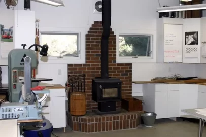

My little workshop stove. Back wall of the hearth brickwork behind the stove is vented along the bottom and spaced 1" from the drywall. Does the same job...but the air space is absolutely essential in either case, as it's the real insulation/convection heat transfer feature. Rick
