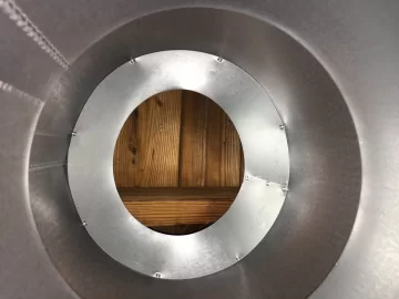

So, not such a piece of cake. I'm going to have to remove an 8" section of rafter in order for the attic insulation shield to fit. I've got very little room to work in and it's difficult almost impossible to fit my 5'4" frame in the area I'm running the chimney. So wondering if it's worth cutting the roof hole larger and stuffing the AIS through??
Here's a shot of the section that will be removed with the AIS pushed through the ceiling

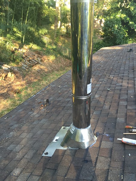

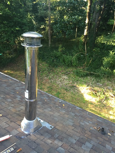

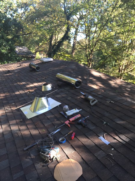

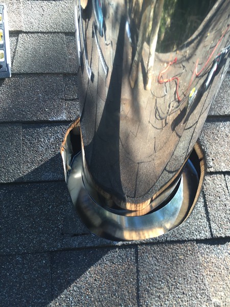

Well, that was a pain in the ass!! But it's done. I decided to sister in a new rafter from the ridge to the top plate. I couldn't fasten the new one to the old one near the soffit as there is no clearance. When I got on the roof and cut a giant ass hole in it, I was able to get a few more in. Rafter complete, I cut the old one and all was well. The AIS was a pain to line up as there just wasn't enough height for it.....all and all....everything is jammed in there with 2" or more clearance. Couldn't ask for anything more....
My mess....
