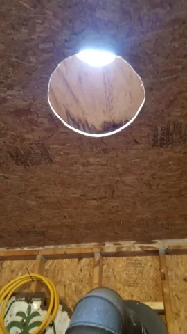

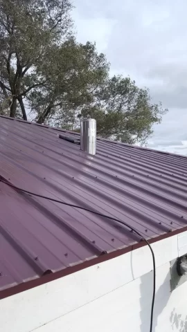

the attached pictures are the rough in. I cut the roof hole bigger but set the pipe in for the photo after I got it lined up. I have about 2.5-3" clearance in all areas and climbed up in the attic yesterday just to feel and check everything in there as well as the roof. Probably wasn't necessary but I like to check anyway. There is also now an additional chimney section on top with a clamp to hold them together.

A storm collar would be recommended. I'll be honest though, it isn't an emergency as long as your jack is sealed right. It will also keep the UVS off the boot. Don't worry about big brackets. You want that baby secure. I do alot of metal roofs, and I have noticed that anything that sticks out of the roof can eventually start walking the fasteners out. Ecspecially on OSB sheathed roofs. Keep movement to a minimum.
