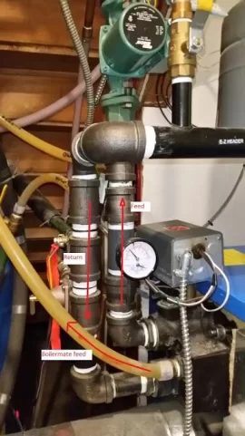

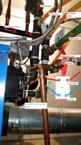

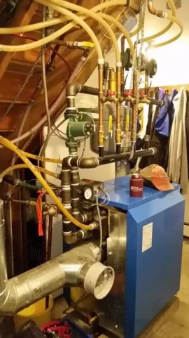

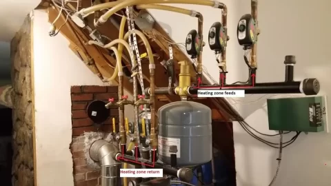

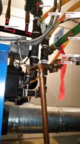

Right now my owb is hooked directly to my FHW oil system. (I will post some pictures below noting how it is hooked up.) The oil furnace is a Buderus, cold start furnace. It only runs in the summer to heat my domestic HW via an indirect water heater(Boilermate), though it is set to come on if the OWB gets too low. [Hearth.com] installing open system owb to closed fhw system

So based solely on those pics, or more exact the second one - I think I would plumb the 'OWB Feed' into one port of the inside side of the FPHX, and the 'OWB Return' into the other. With another circ pump add to that circuit to maintain the flow through it. Should be done either with copper, or O2 barrier pex. Can't tell if the pex in the pic is O2 barrier or not, but it doesn't look like the O2 barrier I have. The boiler mate feed/return lines should also be O2 barrier - and after looking at pics 3 & 4, they all should be also. If you were starting from scratch, you could likely plumb things so the extra pump wouldn't be needed (all flow through the HX) - but looks like a big job rearranging things there for that.

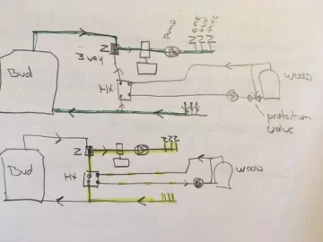

Here is a rough drawing with a 3 way zone valve.
It shows the two modes of operation.
Ideally that boiler pump should be pumping away from the expansion tank. depending on how much repiping you want to get into. isolation valves, gauges, strainers left out for clarity.

The owb boiler has a continuously running circulator. the circulator for the heating zones and boilermate only come on when needed. So is there a place in my system that I can connect the FPHX to maintain this setup without adding another circulator? Bob, from your drawings, it looks like it would go between the feed and return of the heating zones. I just can't figure out how to do that. I imagine I don't want too many elbows restricting flow.
I think it could be done, sure, but would require some re-plumbing of that nice looking cast iron.
Example from your pics, looking at the second one:
If you put the load side of the HX, in the big return cast iron piping, below the fill water piping (between that & the IWB return inlet), then every time your heating circulator comes on it will draw heat out of the HX into the IWB & the rest of the system (as long as heat is being supplied to the supply side of the HX from the OWB). That would be the simplest setup I can see - aside from the re-plumbing job. But the re-plumbing would be confined to that short length of piping. (Plus perhaps replacing all the non-02 pex with 02 barrier). If heat stops coming into the HX from the OWB for whatever reason, then the oil burner would just cut in same as it ordinarily would. That would be a simple series setup.
The possible catch there, that I can think of, is that all your system flow would be going through the HX all the time - so you'd want to be sure the HX doesn't present too much head loss or restriction for what your max system flow would be. (I guess the bigger the HX the better). And also by having all the OWB heat go through the IWB, there would be a bit of added heat loss potential there - but the amount of heat loss may not be a concern, not sure there.
That's what I was picturing, more or less - but I'm no expert either.
(Also think your OWB lines there should be reversed - the two flows through the HX should be opposite each other. I think.)
You are probably right about the flows being opposite. I just have to figure out the best way to hook it into the black pipe.:confused:

Your right Maple they should be counter flow for the best heat tranfer.
