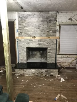

Just finished up this install. It's the travi gray same manufacturer of the sierra you are looking at.
That looks great!

Iif we weren't doing that corner, we wouldn't do the adjacent wall either. We were originally going to do only the wall with the fireplace but wasn't sure how to finish the outside corner so it'll look natural so we decided just to do that corner and adjacent wall too.
I had the same thought about finishing the edge. But when I saw that each outside corner piece was $20+ per piece I just decided to put a thin piece of wood trim on the edge and painted it wall color. It blends right in and saved be $350.
Also either rent or borrow a wet saw with a sliding table. That ledger stone is easy to cut but so fragile. I've installed thousands of sq feet of it. Super easy to install though. Most important part is getting the first course level. After that it goes up fast. That install took me less than 3 hours. Time is in the prep.
