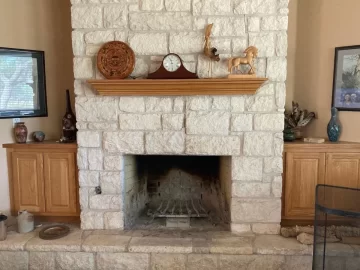

Hi folks, 1st time poster here. We are wanting to install a Hearthstone Clydesdale in our all masonry fireplace. When we built the house 20+ years ago, we didn't notice how irregular the limestone facia is. Now that we will be mounting a flat cast iron surround to the surface, the inconsistencies are very apparent. I cut a piece of plywood matching the surround to use as a template. I'm just wondering if anybody has ran into this problem and how did you solve or compromise the issue?

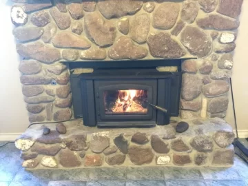

I had a similar issue installing a Blaze King Princess insert. The factory shroud would have looked terrible due to the rough rock on my fireplace. So I made a custom surround that fit inside the fireplace. I designed the surround and went to a local welding/sheetmetal shop to get it made. I had the stove in my possession before making the shroud so that there would be no mistakes in dimensions before the installation. I can't advise too much about your specific circumstances but the point is you don't necessarily have to use the factory surround.
Here's a link to my finished project:https://www.hearth.com/talk/threads...ead-everything-bk.181827/page-25#post-2465880
When you used the template, did the irregularities make it unsightly or just not possible with the insert? We have a huge river rock facade on our fireplace which made it impossible to install the factory surround because the insert ends us being a bit recessed at the attachment points. The surround isn't actually required, but we prefer to have the sides of the fireplace covered. If ours attached, I would have it installed in front of the river rock and been happy. There would have been gaps, but I don't believe that installs with full liners have any requirement for the faceplate to be sealed. Nobody spends much time perpendicular to our fireplace facade, so I don't think the gaps would be particularly noticeable.
We haven't completed any nice custom surround as fiddlerbob did above, but that's the idea that we were looking at. Right now our surround is disassembled and the sides just rest between the insert and the fireplace walls. We'll get there someday.
I think a Clydesdale would look very nice set against that Austin stone fireplace. What kind of firewood do you have in your part of the state? We have lots of live oak and cedar.

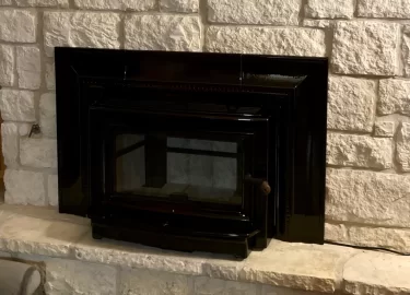

[Hearth.com] Installing Wood Insert to Limestone Fireplace
You can see some rockwool insulation peeking out over our side surround panels where we haven't yet installed the modified piece up above.

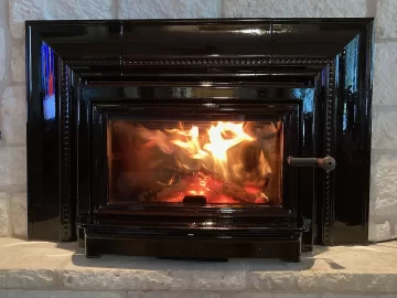

We were able to get an early slot on the installers schedule. He finished in the evening yesterday. We will run a break-in fire tonight but we are on a warming streak until around Christmas Day. Will probably run it all day if that happens.
Another option would be to replace it with a white cord or paint it with almond or antique white paint.
That looks fantastic! Thanks for posting the photo. We'll need one when it actually has fire, you know.
It may be different in person, of course, since I am just looking at a small screen, but that brown enamel is so eye-catching, I didn't even notice the cord until I looked for it. How are the gaps between the limestone and surround now that you actually have it in place?

The cord lacks about 6" reaching the wall plug. I was thinking about shortening the cord and moving the plug to just outside the surround, and using an extension cord while it's being used. I will work with it for a while before I cut the cord

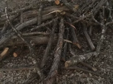

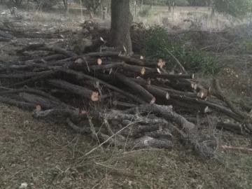

[Hearth.com] Installing Wood Insert to Limestone Fireplace[Hearth.com] Installing Wood Insert to Limestone Fireplace
Those are just a couple of piles we still need to clean up. We concentrated on chipping first, and we need to get to sawing soon. A lot of people would scoff at the small wood, but our land is full of it, and I'd much rather use it to add heat to my house than pay to haul it to the landfill.
