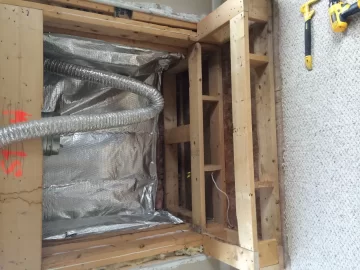

I'm rebuilding my hearth in perpetration for a new pellet insert. I noticed there's no insulation on the bottom of the bump out. Should I insulate this area? If so is there a certain type. Thanks.

It a framed bump out that previously had a prefab. I'm putting in a harman pellet stove. I'm specifically talking about the area underneath the firebox.

It's a framed bump out. I removed the builders grade prefab fireplace and will be installing a pellet insert using a zc box. Should I insulate the bottom of the firebox, which is the same as the bottom of the bump out?
Yes definitely insulate the bottom of the chase if it is not currently insulated. Any part of that chase that is exposed to the exterior of the structure should be insulated at least to the same degree as the remaining exterior walls of the home. Seal any gaps with foam or caulking to stop air infiltration, taking time to do this will pay dividends in the long run.
Is it better to use roxul (stone wool) or regular fiberglass insulation? I know the ZC provides fire protection but...
It would be fine to use roxul as long as it meets or exceeds the R value of the rest of the building envelope and a vapor barrier is installed. I wouldn't be hesitant to use fiberglass though, as long as it is installed to meet the clearances of the ZC box going in.
