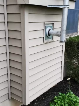

Can insulation catch fire on a 4-in double wall vent pipe? I recently pulled the back wall plywood off that contains my quadrifier AE insert and insulated around the base of the box. See attached. I fear when I did this I may have gotten insulation close to the 4-in double wall that pipe and want to make sure that I'm safe to burn the pellet stove.

What kind of insulation?
Most insulation will not burn and besides your
double wall pipe should not get hot enough
to get it to caught fire.
You could use this around your pipe.
(broken link removed)
